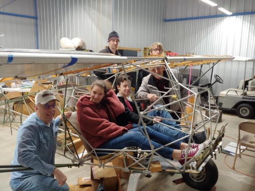

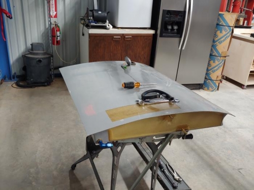

Good turn out, with the following in attendance: Terry, Pete, Hannah & father, Frank, Brian, Nick, and Jordan. We sloshed the left tank with acetone. We plan to repeat with gasoline next week then bond in place if time permits. We installed the floorboards, both plywood and aluminum scuff plates. We need to drop the gear to gain access to the rear most two attachment holes for the floorboards and control stick tube to drill the holes through. Haven't made much more progress on the panel, but if time permits, we'll drill a few more holes.
Most of the crew with a cockpit fitting
fuel tank and fittings ready for
fuel tank and fittings ready for "sloshing"
