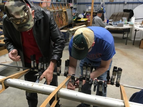

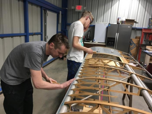

Most of the work was on sanding the wings to prepare for varnish next week, along with using basswood strips glued in with T88 to stiffen the trailing edge aluminum in an attempt to stiffen it against warping when the covering is applied and shrunk.
Jordan and Bryan sanding polyfill and ribs
We still need more clamps!  Attempting to keep the basswood secured to the aluminum
