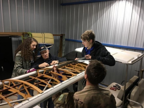

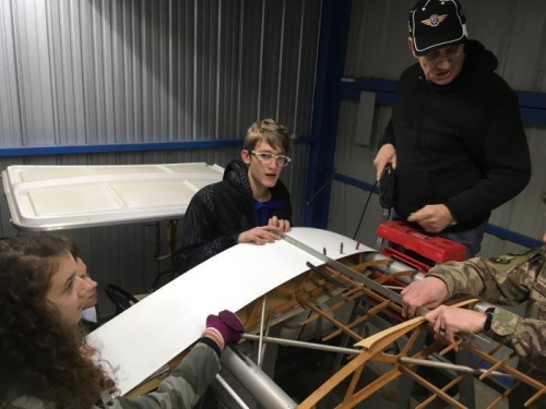

Work was primarily centered on attaching the left wingtip. We used a centerfinder to locate where to drill the holes (1/8" bit) for the screws that will hold the wingtip in place. All the holes got drilled, and clecos are in place awaiting the screws.

Eric shows Hannah how to align the trailing edge of the wingtip
Jordan used a straighedge to align the wingtip while Ferenc holds it in position and Eric drills
