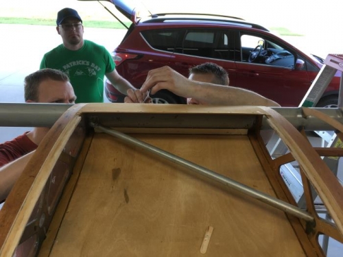

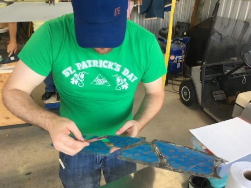

Worked on attaching plexiglass sides to both wing lockers. In order to make the glue less "sloppy" we taped off the areas that did not require glue. We hope for a better appearance. We also used fishing line and rubber bands as clamps to ensure good contact.

cove molding glued in for better stability and clamped with fishing line.
applying tape to wing locker sides to prevent glue smear
