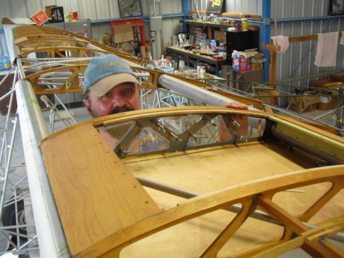

Micheal bonded the left inboard wing locker plastic piece in place.
Brian, Jordan and I completed the shims, bolting and drilling of the right flapperon brackets (took longer than expected). We'll work on the left one after OSH. So, last night was a successful meeting, was the culmination of a lot of work on previous session that all finally came together. Check out the attached photos. We'll be at OSH from the 18th - 29th. Next Kitfox work session is 1 August.

Michael working on bonding the sides of the wing locker.
