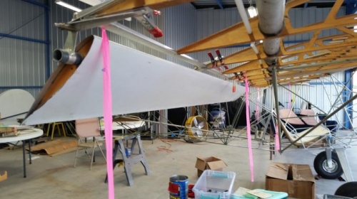

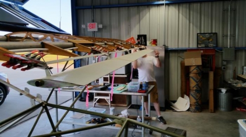

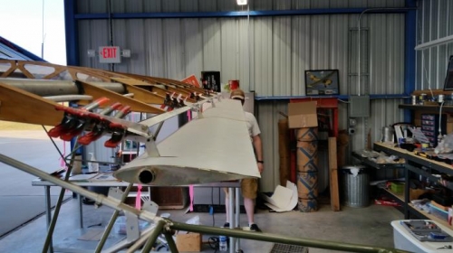

Brief Description:  flaperon work
Terry, Brian, and Eric were on site from 6:00 - 8:30.
Decided not to bond the strips to attach the wing tips as discussed last week. Test fit the aluminum flapron hangers to the right wing ribs. Still struggling with flapron hangars on the back edge of the ribs. They won't work/fit the way the plans say they should as built. We decided to move the attachment aft 1/4" from the plans and shim the bottom to suit the situation on each hanger. We drilled the top of the outboard hangar and celcoed it in place on the rib. We then attached all the other hangers using clamps in the same manner and then bolted/celcoed the right flapron in place on the hangers. We were able to aline all the hangers. See attached photos.
