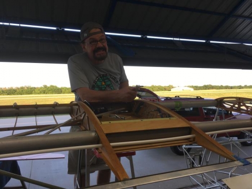

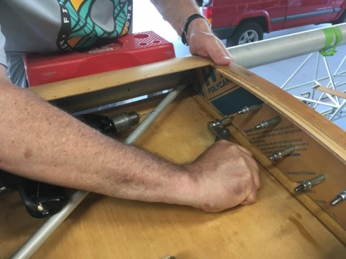

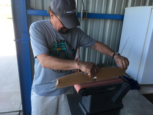

Michael spent approximately two hours preparing the plexiglass sides for the wing lockers. he used a belt/disk sander to shape the plexiglass sides, and then drilled an clecoed them in place in preperation for gluing them in. The clecos will be used as clamps while the adhesive sets up.
Michael using a belt sander to shape wing locker sides
cleocoing in place
cleocoing in place
