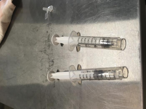

syringes used for measuring epoxy by volume (3:2)

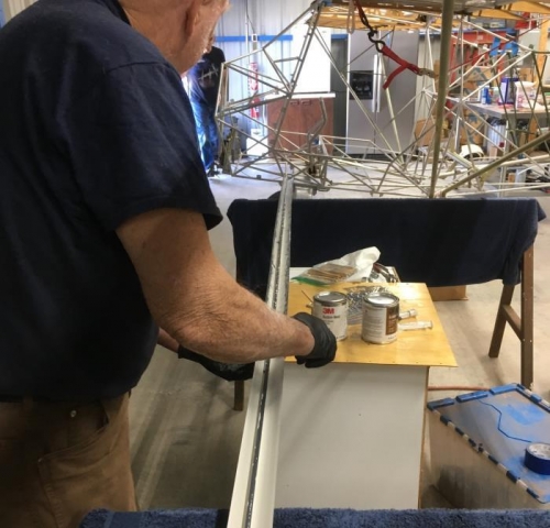

Art applying epoxy to leading edge

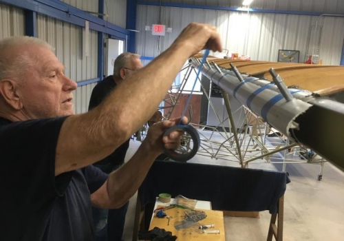

Art and Terry applying tape for clamping pressure while clecos hold for positioning
