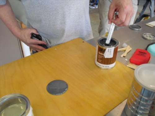

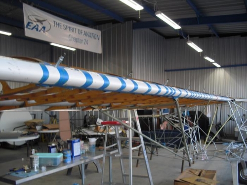

Greg, Eric, Art, and Jay (6 hours) worked to apply the leading edge to the starboard wing. Most of the prep work was done last week. We applied painters tape to just above and just below the leading edge to minimize drippings. We also used the tape as "clamps" to apply some modest pressure once the leading edge was in place. The clecos in the small 3/32" holes that we drilled did a great job in keeping the leading edge in the right position.

Applying the structrural adhesive to the leading edge
mixing the adhesive
mixing the adhesive
leading edge in place and clamped with tape
