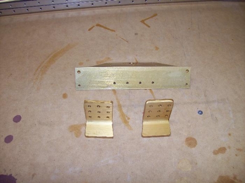

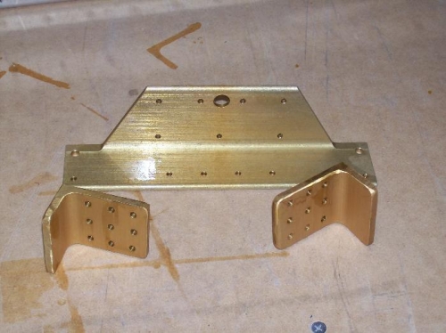

Brief Description:  alodining 101
This was my first experience with alodining. This is the pair of angle attach brackets for the HS and the rudder horn from the rudder, these are the only non-alclad parts in the empennage. Due to their small (relatively) size, I immersed them in both the alumiprep and alodine solutions in a large plastic cup. I diluted the alumiprep 33 according the directions for clean metal at 5:1 for immersion, and 3:1 for the alodine. Before the prep solution, I washed each part with soap and water, then wiped them down with laquer thinner to remove any remaining oils. I don't have any other examples to compare this to other than pictures on other builders sites - and these look identical to those, so I suppose I didn't screw it up too badly!
first alodining attempt
closer view
closer view
