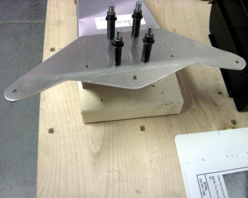

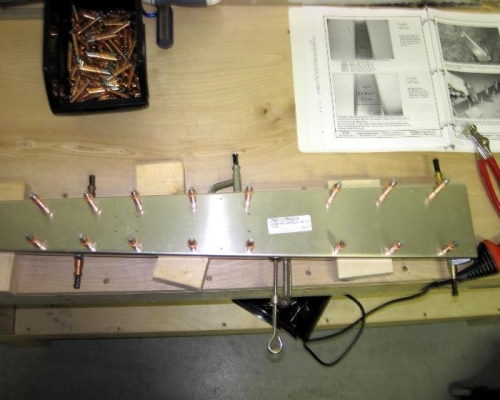

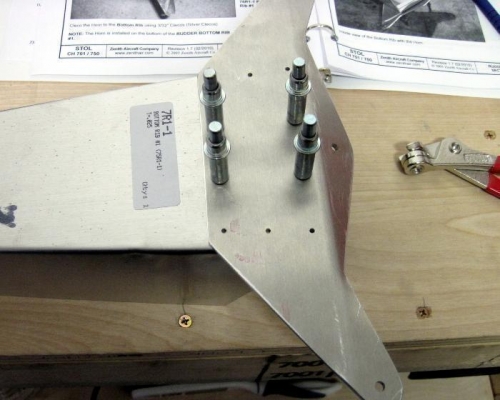

After drilling and securing the doublers to the spar with Clecos, I filed smooth and deburred the edges of bottom spare and lower hinge/control horn. Then clecoed the bottom spare to the lower hinge/control horn for drilling holes to final size. Then clecoed with the black clecos.
Doublers Clecoed in place
Lower hinge/Horn clecoed to bottom spare for drilling
After drilling to size
