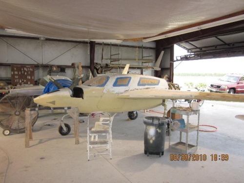

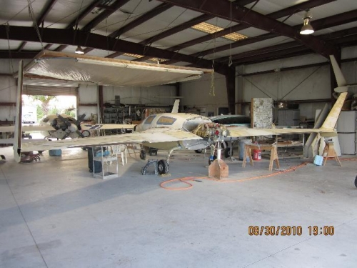

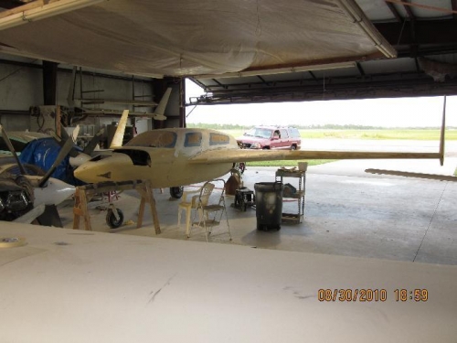

Date:  8-30-2010
Number of Hours:  11.00
Brief Description:  Wings on finish work
Installed both wings onto airplane. Had to cut out a little of the firewall so that the inboard attach point would make good hard point to hard point contact. Microed strakes, doors, windows, and wings. Had to fill in a valley in the wings just aft of wing spar.
