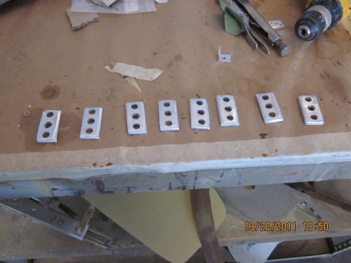

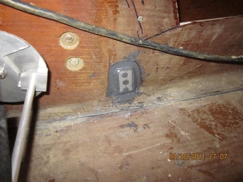

Made hard points for seat belts out of 1X2X1/4 aluminum stock. Tapped to 7/16-20. Used cabo and flox to imbed rear seat outboards into sidewall. Used structural epoxy on remaining. Covered all with 2 bid.

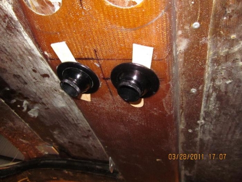

Installed aluminum "nuts" for overhead vents inside plenum using structural epoxy. Installed a wireing tie point in nose for landing light. Structural epoxied in a shim over the canard bulkhead canard attach points.
Seat belt hardpoints
Copilot outboard seatbelt hardpoint
Overhead vents
Overhead vents
