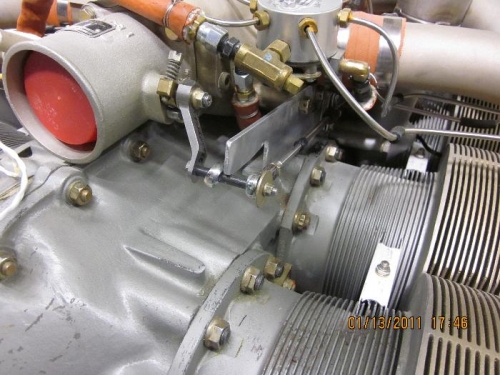

Completed installation of throttles to throttle bracked.

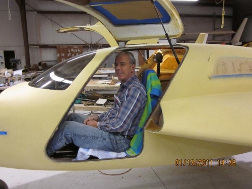

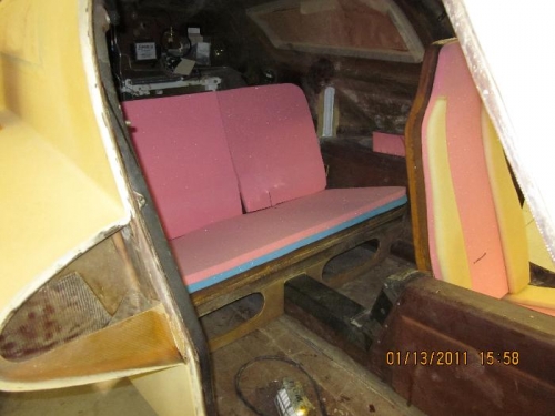

Picked up seats from upholsterer with foam installed. Installed pilot and back seat in airplane to check for comfort and fit. Indexed back and seat of rear seat. Had lunch while sitting in pilot seat. Found it very comfortable and there appears to be adequate headroom as constructed. Back seat was also suprisingly comfortable. Seat bottoms are constructed with 3 layers of 1 inch memory foam layerer bottom to top as firm(green), medium(blue), and soft(pink). Seat backs are of 2 layers of blue and pink. Pilot seat should be optimized by adding additional hard points 2" forward of current installation.
Discussed upholstery plan with upholsterer. Seats all light grey. Darker grey along sides, door posts, and ovhd plenum. Headliner where headliners go. Carpet over tunnels, keel, and up rear seat forward support. Dark grey vinyl around com panel. Will fabricate a fiberglass moulding to cover entire bottom of strake window area.
