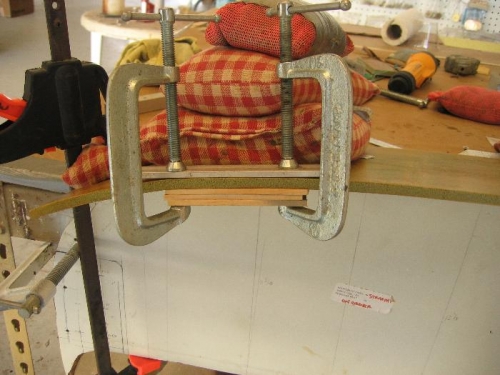

Brief Description:  Glare shield fitting
Filed and sanded glareshield to fit. Bent glareshield using heat gun and weights to conform to shape of top of panel. Could not get glareshield to set properly, so I decided to build "slot" along the bottom of the windscreen where glareshield would fit into. Used 3/8 inch divinicel as a spacer and. Attached the divinecel to the windscreen with masking tape then hot glue over the masking tape. After forming a nice radius under divinicel with micro, I wrapped it in 3 bid.
Shaping glareshield to fit panel
