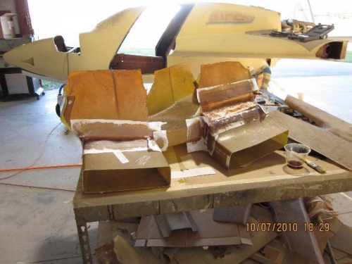

Michael worked on the doors and I worked on the engine plenum. Removed doors and installed locking mechanisms per the manual. Started fitting door panel with wooden dowels as spacers. Decided to alter installation a bit by using velcro instead of screws to install panel.
Glassed runners to plenum and sparkplug access covers. Made flanges for top of runners next to firewall

plenum being fabricated
