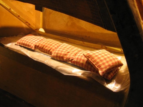

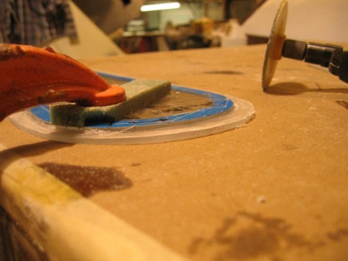

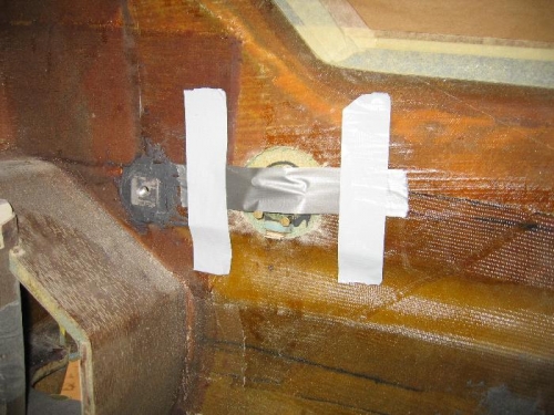

Cleaned up previous glassing. Spent about 3 1/2 hours creating a rabbit (?) along edge of strake window so the bottom of window would be flush with bottom of fuselage. Used a die grinder with 36 grit sandpaper to do this. Installed window to lower strake lower skin with structural epoxy and flox. Removed outer skin and foam for fuel sender bracket. Installed bracket with structural epoxy and foam.
Window clamped to table for die grinding
Weights to hold window in position
Fuel sender bracket epoxied in
