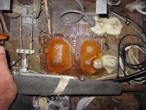

Found 2 roll servo hardpoints that had debonded from floor. Hard points were structural adhesive and flox with no fiberglass . It appears that debonding caused by applying structural adhesive over some old spilled epoxy. The spilled epoxy did not bond well with floor because it was unintentional and there was no surface preparation. Crafted new hardpoints with epoxy, flox, cabo and 2 bid.

New roll servo hardpoints
