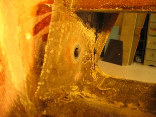

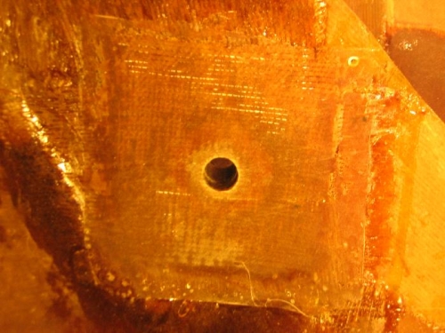

Main Gear Knurled bushings.
Open up holes to knurled bushing in firewall. Ground off and and sanded fiberglass off surface of bushings in gear well.
Had to redo gear leg socket for Pax side because release tape pulled away from gear leg on original which in turn deformed the socket.
Bushing hole opened up
bushing surface exposed inside gear well
