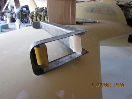

Finished keel cover hole by trimming flaps to fit. Shortened aluminum flanges inside keel to match the com panel so that flaps would fit tightly against top and bottom. Heated and bent the flaps to move them about 1/4 inch more together for better fit.

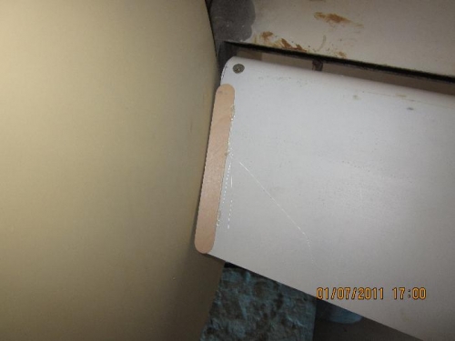

Marked inboard line for elevators for later fill (to match fuselage).
Upper and lower
Upper and lower "flaps" in keel cover opening
Glued on tongue depressor to mark elevator

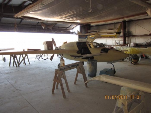

Taking Shape!
Taking Shape!
