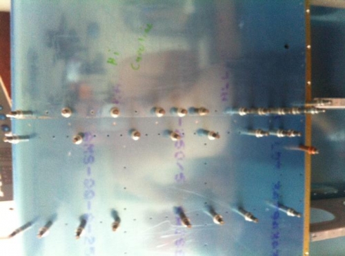

Today I mounted the cleco'd left tank to the leading edge and I discovered a problem. The tank and leading edge seam was tight however the W423 joint plate was not manufactured with the correct amount protruding from the edge of the leading edge rib. I noticed the the W423 edge was visible in the holes along the W701 tank skin. I re-did the W432 to insure that there was 11/16 of the W423 to insure plenty of edge distance once mounted the the 701 skin. The outboard 410 rib is 3/4" in from the edge of the 701 skin edge. Once I re-drilled the W423 to the outboard wing skins it married up correctly and there was no gap in the seam.
Leading edge all mounted
No gap in seam
No gap in seam
