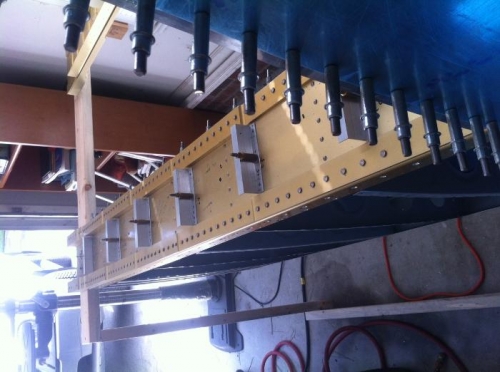

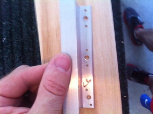

Drilled nutplate holes into left T-712 angles. I elected to flip angles to the backside of spar and match drill thru main spar. Results were good and holes were aligned when flipped back to leading egde of spar.
