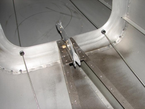

elevator bell crank
deburred, drilled and riveted the bell crank. Installed same with hardware callout in fuse... An4 torqued to 60 inch pds. As you can tell, there is some overspray on the bottom of the fuse skin, this will eventually be covered by insulation.
