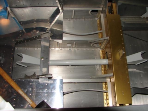

Date:  10-9-2006
Number of Hours:  1.50
Brief Description:  installed flap control bar and control bar
pre-fit the flap control bar.... fitted and drilled the blocks on the drill press. Fit them to the floor and drilled with a number 12 on the right angle dirll,, glad I have that piece of equipment. Placed the an3-7a's in the holes to "pin" them. Drilled the contol bar bearing holes out to fit the an3 hardware. installed the bearings, then temporarily set them in place.
