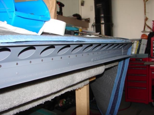

Brief Description:  wing flap bracket
fit, drilled, deburred, dimpled, primed the flap bracket. It is riveted to the spar, but did not rivet to the skin (I think thats were the hinge gets attached). once the flap was lined up to the aileron,, I found an offset of about 1/16-1/8th of inch difference... I've ordered a hinge that is a dash 4 instead of a dash 3, this (in the faq) apparently fixes the difference in the line up. Once it gets here, I'll re install the hinge with the -4
