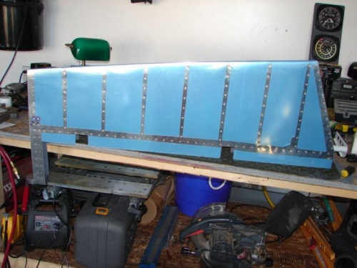

Number of Hours:  3.25
Brief Description:  right elevator
after fabricating the tight space dimpling tool, I set to work on the balance of the right elevator.dimpled, primed, re-assembled and riveted. As you may well see,, I only final riveted one side as the other side needs to stay open for the final inspection. Then I can roll the leading edge, rivet the other side and it will be finished. I expect another 1/2 hour of squeezing and I'm done.
