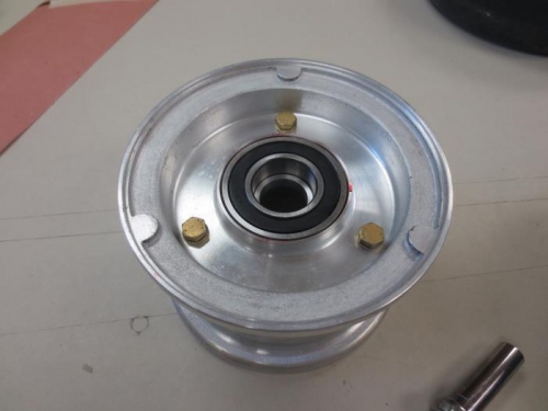

Brief Description:  Worked on nose gear service bulletin
Today I installed the new nose gear bracket to comply with SB 07-11-09. While I was at it I had a friend install sealed bearings in the nose wheel. Thanks to Colin Peterson. This is a good mod that will allow easier maintenance of the nosewheel. The bearing part number is 1654-2RS.
Hub machined
Hub machined

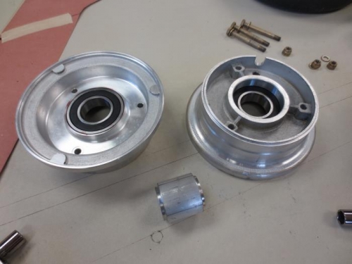

Bearings installed and spacer made

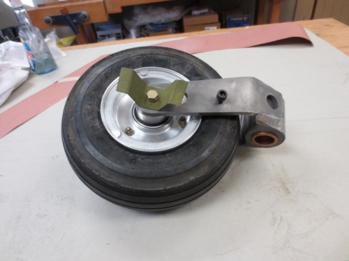

Completely installed nose gear bracket
