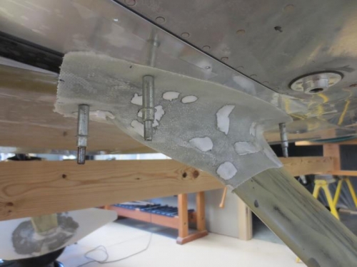

Worked on the left gear fairings today. On the upper I filled some holes, heated the fiberglass slightly to make it fit properly and bedded in some more fiberglass between the fairing and the plane. From now on I will apply all layups before removing. The fiberglass is too flexible to apply layups before it has multiple layers.
Upper left gear fairing
