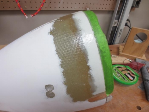

Date:  8-31-2015
Number of Hours:  1.00
Brief Description:  Started left wheel pant
I sanded and laid up some fiberglass near the junction between the front and rear half of the left wheel pant. When I joined the two the rear section was lower than the front. I laid up some fiberglass on the rear. I will join the two and sand them even.
Building up left wheel pant
