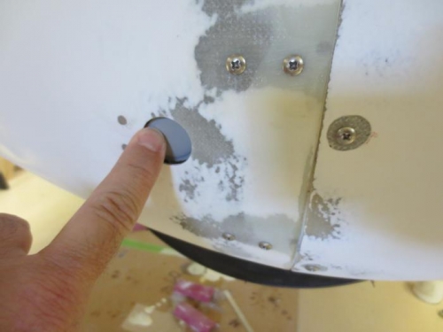

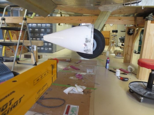

Brief Description:  Installed door for tire air valve
I purchased tire air valve door from Wicks Aircraft, P/N KM713-16-032. Used the laser to line up on the air valve, reinstalled the pant and drilled where the red dot marks the spot. Kind of hard to see the red dot in the photo.
Marking right pant for air valve door
Air valve door installed
