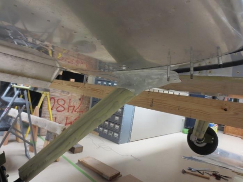

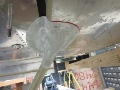

Brief Description:  Finished upper right gear fairing
I finished sanding the upper right gear fairing. I installed a plate nut under the lower stringer in front of the gear tower with countersunk blind rivets. I little difficult but it is done. The other platenut that I installed is behind the main spar under the aileron push tube. The ofther fasteners share that of the wing root fairing. It was a very good fit. It was molded in place.
