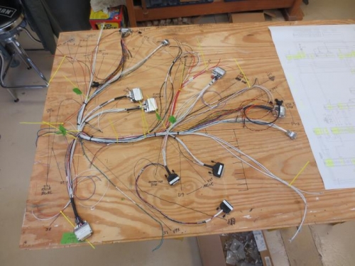

Brief Description:  Completed wiring harness
My wife and I completed the point to points on the avionics wiring harness. Sure am glad I took the time to do this step. I did not find any problems with my other wiring harnesses but this one had a few goofs. If you make your own harness take the time to point to point each connector. This would have been very difficult to diagnose in the plane.
Wiring harness completed
