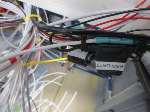

Brief Description:  Installed charging fuses

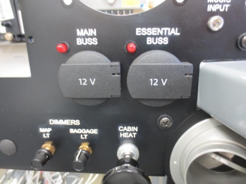

When I installed the wiring to connect the power outlets on the panel I neglected to install the fuses. Nothing like going back in and redoing. Installed a 15 amp fuse on the line to the main and essential battery. Opted for fuses because they are not flight critical and should never give a problem. They are accessible reaching under the panel. Worst case I would remove the right Dynon screen and they are visible.
Fuses installed
Fuses installed
Power plugs on panel
