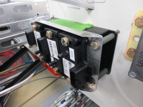

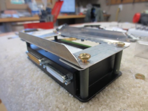

Brief Description:  Installed manifold pressure sensors
My goal for this aircraft is to be maintenance friendly. I found some valuable real estate right on top of the Dynon EMS-220. This is directly behind the passenger's Dynon HDX panel. Built a bracket that stands off of in front of the EMS-220. I installed platenuts for future ease of maintenance.
Manifold mount on top of EMS220
Manifold pressure mount
Manifold pressure sensors installed
