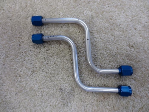

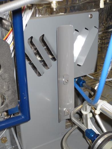

Brief Description:  Finished heat shield on center wire bundle

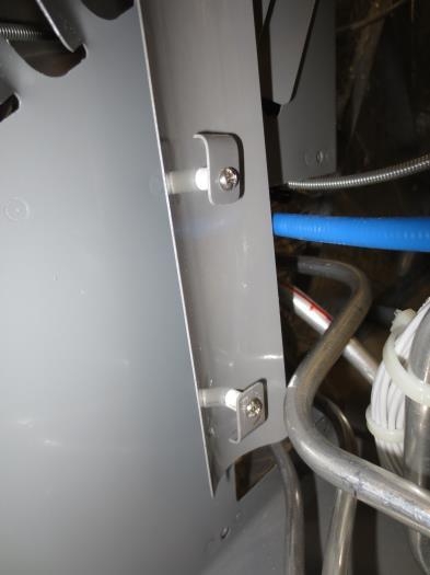

Sometimes you figure that a job is only going to take 15 minutes. Then reality set in. The heat shield fit well but the wiring harness was up against the fuel supply line. I made a new fuel supply line with an additional 1" offset. The wire is inserted in a wire loom for a finished appearance. I split the wire loom down the side and turned to the back. This will make for a neat appearance once all of the tunnel covers are made. Only about 8" of the wire will need to be covered.
Standoff clips
Standoff clips
Heat shield in place
Changed offset in fuel supply line
