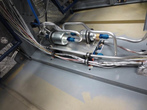

Brief Description:  Wiring in forward center tunnel
The wiring from the rear of the empennage comes through slots cut in the center portion of the wing spars. They will be trimmed out with rubber to protect the wiring. After all of the wires are added that need to go to the wing I will lace them up neatly and use the proper size Adel clamp.
The wires are going to run vertically up the firewall in right in the center. This will put it right in front of the heater exhaust between the louvers that divert the air to the left and right side of the cockpit. I fabricated a heat shield to protect the wiring as it passes in front of the heater outlet. Did not take a picture when I fit tested it. After the paint dries I will install tomorrow and take a picture.
Wiring on forward tunnel
