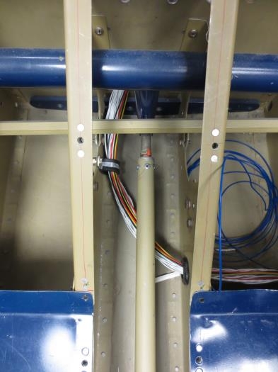

Brief Description:  Running wire from rear of aircraft through wing sp
Ran the wire loom that came from the rear of the empennage through the floor stiffeners, up through the wing spar, down the center tunnel and up to the avionics. Punched three 7/8" diameter holes for the rubber grommets in the floor stiffeners. The Adel clamp is oversized until I add the wires to the wings.
Wiring from rear of aircraft

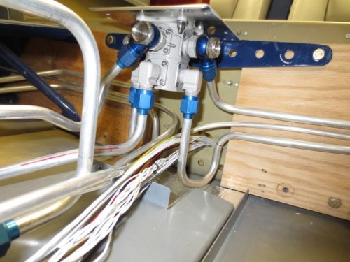

Wiring through center tunnel
