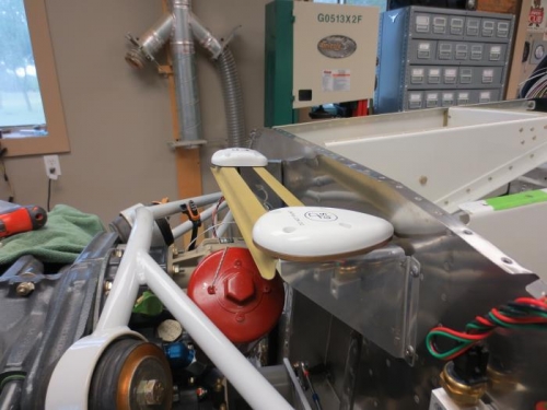

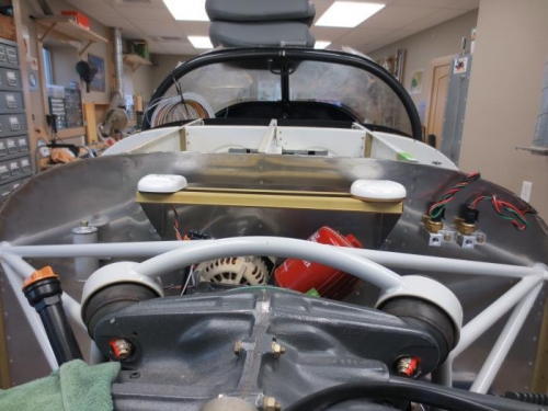

Brief Description:  Installing GPS receivers under cowl
Mounting the Garmin and Dynon GPS receivers under the cowl. I should be able to remove the oil filter with having to remove the GPS receivers. Worst case I will have to remove the four screws and move the bracket. All fits well. The receivers are spaced 12 1/2" center to center. The angle has been adjusted so that the receivers are parallel to the longitudinal axis of the plane in flight. Next step is to remove and paint.
Side view of receivers
