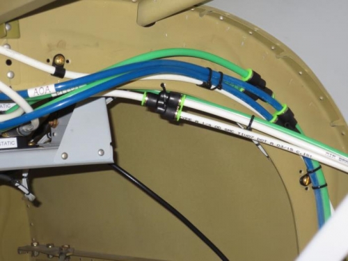

Brief Description:  Alternate static air
My panel has a alternate air source for the static air. I needed to run a line for this application. I put a splitter on the static air line and tied it to a bulkhead. The line then runs under my avionic tray and down the side of the fuselage. I am going to wait to finish securing it under the panel until my wiring harness are in. I will be able to tie it off to wiring bundles.
Static air split
Static air split
Alt air static line going forward

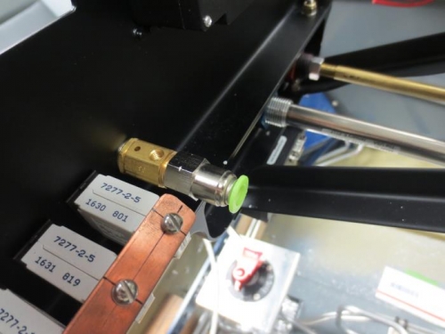

Backside of alt air
