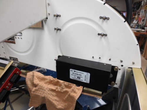

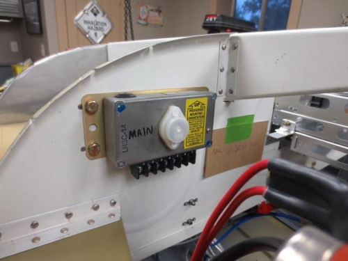

Today I laid out where the avionics were going to be installed on the subpanel. Focused heavily on access to each of the components and how the wiring was going to be routed. Cardboard cutouts were utlizied to facilitate the design.
I mounted the Skyview COM behind the subpanel so that the coax cable would not have to make many turns and eliminate any penetrations. I did install nut plates so that the removal would be as easy as possible.
Main alternator voltage reg installed
Skyview Com radio installed
