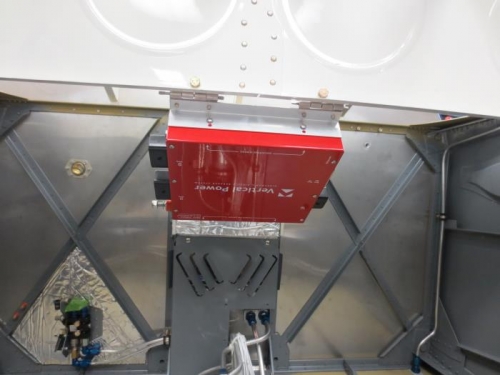

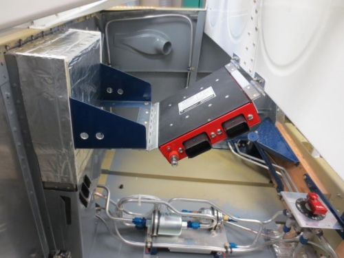

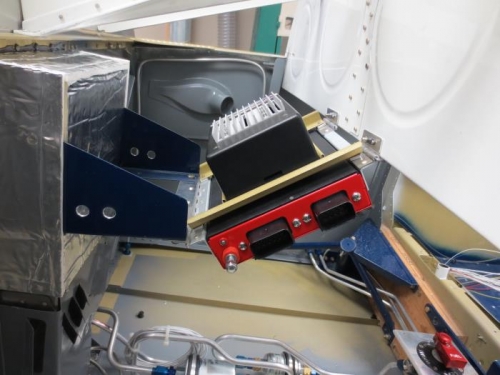

Brief Description:  Installed Vertical Power and Bus Manager
The Vertical Power and Bus Manager was installed in the center area just behind the firewall. Both of these items swing down by removing two AN3 bolts. I put nut plates on these to make accessing them easier. I still have to put two zip ties to hold the Bus Manager in its tray. I will do that after running the wiring.
Vertical Power Installed top view

Bus Manager installed
Vertical Power installed
