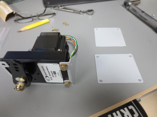

I laid out the location of the roll servo from Dynon. Their kit has it installed in the outer bay in the fuselage just aft of the aileron push pull tube. I laid out the four holes that I drilled through the belly skin of the aircraft. I had to trim some of the ribs to allow clearance for the push pull tube.
I had to fabricate shim plates to make the bottom level for the roll servo bracket. All of the brackets are fabricated and are ready to install. Dynon's package was missing two lockwashers so I will go to town and pick up some.
Roll trim brackets and shims
