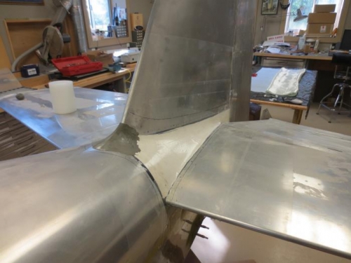

Brief Description:  Building stabilizer fairing
The fairing that came with the kit did not fit very well. I heated it, bent it, pushed it, and it would not fit correcty. My solution was to cut it up, use it as a mold, cover it with clear tape and build new fairings. The next step was to lay up successive layers of fiberglass and pop off a new fairing.
Stabilizer fairing ready to be applied
Two layers of fiberglass applied
