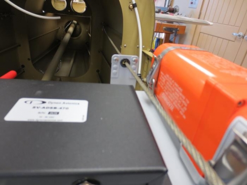

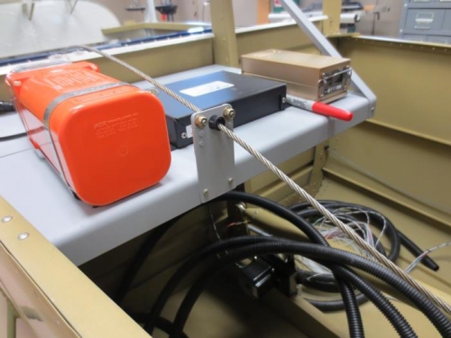

I got lucky. I built the shelve for the avionics behind the baggage bulkhead and then remembered that the shoulder seat belt wire runs through this area. I laid it out and it passes about 1" over the top of my ADSB receiver. When the seat belt is relaxed it slightly rests on the receiver. I installed a support to keep it from touching the receiver.
Seat belt harness support
Seat belt harness support back view
