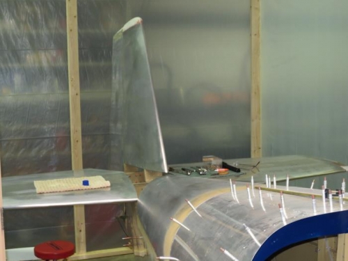

Brief Description:  Installed vertical stabilizer and rudder
Installed the vertical stabilizer and rudder. Checked the elevator and rudder travel. Elevator was 29 degrees up and 22 degrees down. This is one degree less on the up and 3 degrees on the down from factory specifications. I will spend some time to get these couple of degrees back.
Installing the vertical stabilizer
