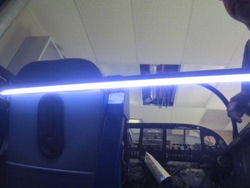

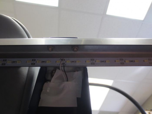

The baggage light is installed on the Almost 14 mod horizontal seat brace. It is affixed with double sided tape to the inside angle facing backwards. This directs the light down and straight back with none of the light rays going above the horizontal. The dimmer control allows infinite control of the output.

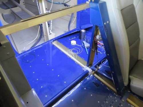

This took so long to run the wire and reloom the harness up through the center tunnel. I used some Gorilla tape just to keep the wires down so they would not get snagged with luggage.
