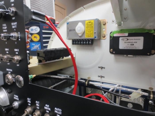

Brief Description:  Installed fuse block for heated seat and fuel pump
After the wiring was run up to the back of the panel I needed to get some power from a relay. There was not enough capacity left on the Vertical Power so I am having the Vertical Power power a relay. The power feed to the relay will come from the main battery through a traditional circuit breaker.
Each of the fuel pumps have their own independent relay. I grouped all three of the relays together in a block that will allow me to just pull the relay out like in an automobile. All three relays are identical and if one of the fuel relays fail while I am away from home I can steal the one from the heated seats.
Side view of fuse block
