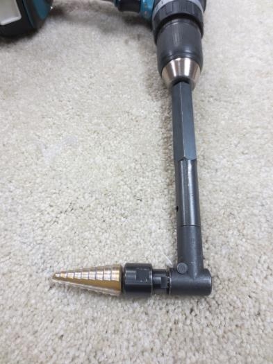

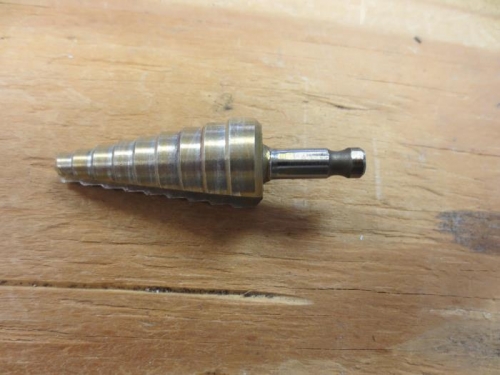

I needed a really short coupled right angle drill and bit to fit inbetween the ribs under the seat pan. Had to make a path for wires. I took a standard bit from Harbor Freight, turned the shank down to 1/4" and shortened the shank so that the base of the bit fit flush against the right angle drill.
Modified bit
Modified bit
Short right angle hole saw
Just fit
Just fit
