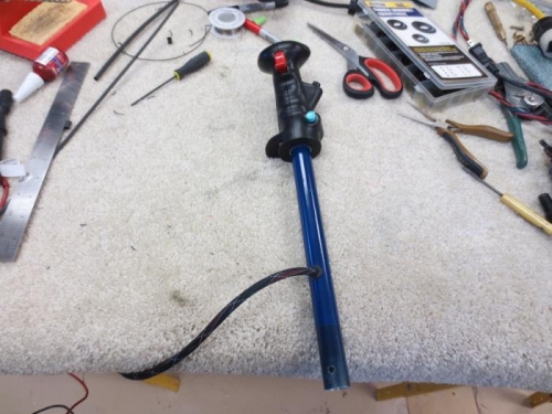

Brief Description:  Installing the Infinity grips

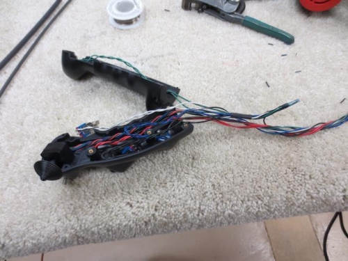

Started the installation of the Infinity grips. I removed 3 - 11/16" from the copilot's stick. I combined all of the ground wires on the Infinity grip so that the wire bundle would reduce from 17 to 11. Did this to minimize the size of hole that I had to drill in the stick. Drilled a 3/8" hole and installed a grommet with a 3/16" ID. Just need to attach a guick disconnect.
Combined ground wires
Grommet in .375 hole
Mostly complete
Mostly complete
