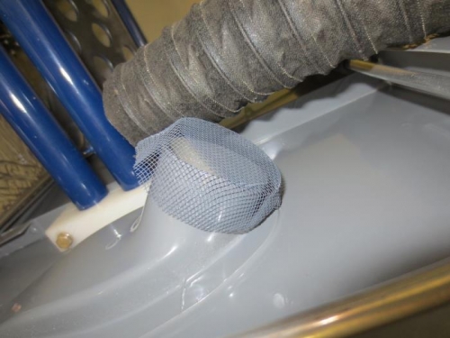

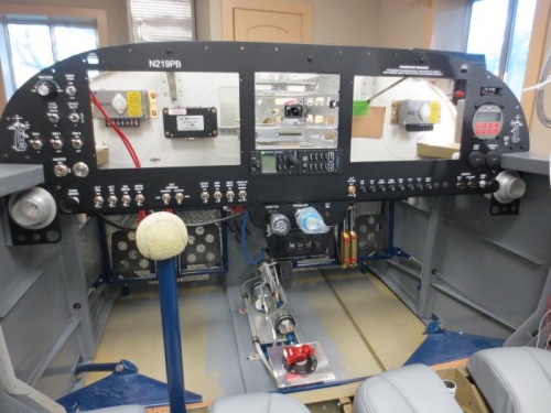

Installed the large size Stein air ducts this evening. I opted for the larger size due to the south Texas location. Aluminum screen material was used to prevent criters from entering the cockpit. I had a piece of 2" OD plastic pipe that was left over from my central vacuum system. I formed the screen over the pipe and laid it over the exit of the NACA duct. The ducting was slipped over it and clamped in place.
Air vents complete
Air vents complete

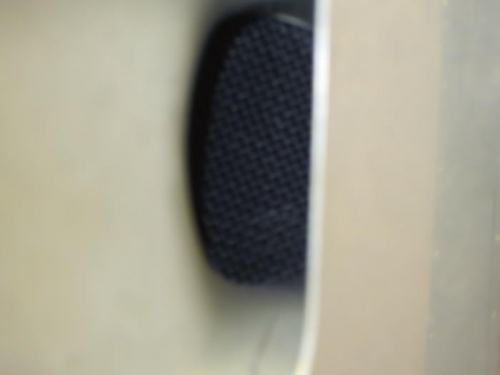

Screen on NACA duct
Screen on NACA duct
Screen in NACA duct
Screen in NACA duct
